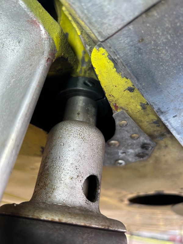

Replied by Jerry Nograsek on topic MLG oil
Honing it has nothing to do with the STC. You should hone the inside of the cylinder when replacing the “O” ring. This does not involve the STC

Replied by Scott Thiel on topic MLG oil
I guess that’s my next step. I’ll get the STC rebuild from alpha aviation.

Replied by Kenneth Crofut on topic MLG oil
Have you honed the MLG cylinder and changed the cup (Dot 5 fluid) or o-ring (5606 fluid) whichever seal you have.
I did that this morning. I had that oleo moving smoothly and freely, but after a flight, it was stuck high again.
Google ercoupe.info it has detailed instructions on how to service landing gear.
