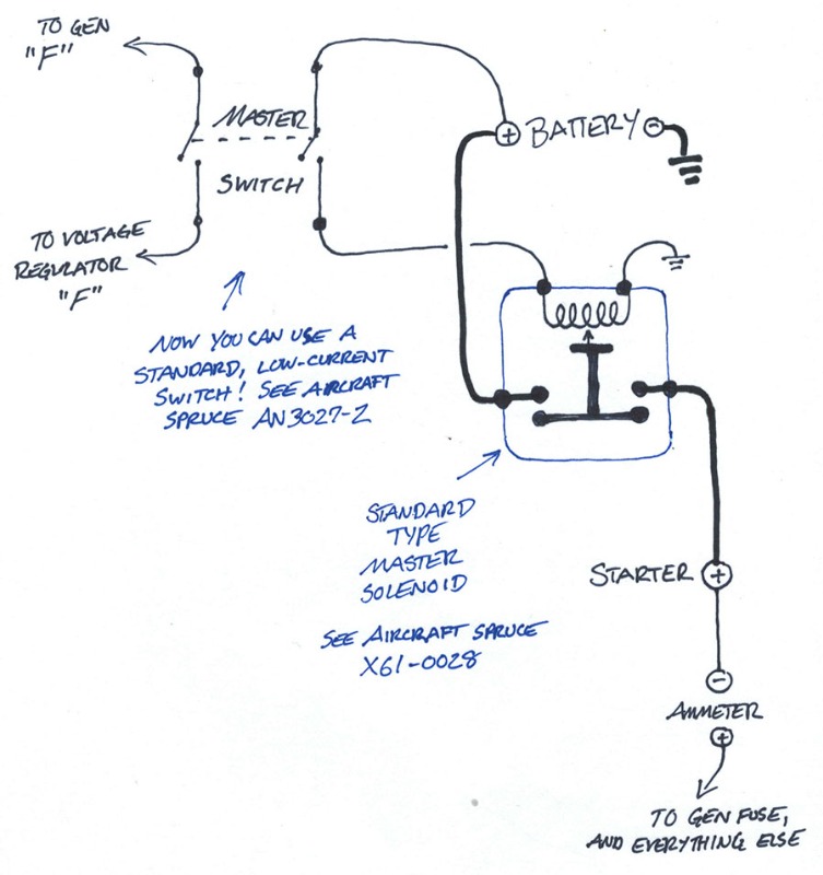

I hope it's not too hard to get to the bottom of it!Since you're still working, I'll add in a couple pieces of information just in case they're helpful.
1. If you have a bad voltage regulator (my plane did when I bought it) instead of putting in another antique Delco-Remy unit, I went with the solid-state electronic PMA replacement . It's lighter, has no moving parts, and basically does everything better, including a "soft start" to save wear on the generator, and it can automatically flash the field when needed.
The only downside is that although it mounts to the same holes in the same location, you need to buy mounting bolts that are about 1/4" shorter (or stack up a bunch of washers... ugly!) because the base flange is thinner. The original voltage regulator mounting bolts will "bottom out" their threads before they tighten down on the new unit.
2. If your master switch is faulty or intermittent, a new high-current switch is too expensive, and the old kinda-high-current switch is, I believe, only available in new OLD stock or used. I still don't trust them. The Alpha Aviation STC is $300 and comes with all the parts needed... it removes the high current from the switch - now the switch only carries 0.8 amps to activate the solenoid, and the solenoid does the "heavy lifting" of feeding many amps to the starter.
Compared to my previous drawing, the solenoid STC changes your wiring to this:
(There's also a voltage spike protection diode in the STC kit, I just didn't draw it)
