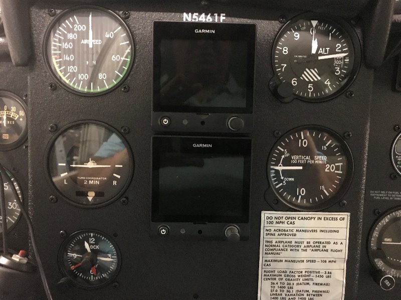

There are pictures attached about 4-5 posts down.

Gordie, thanks for sharing, really good info. A pic of your panel with this instrument would be cool.
