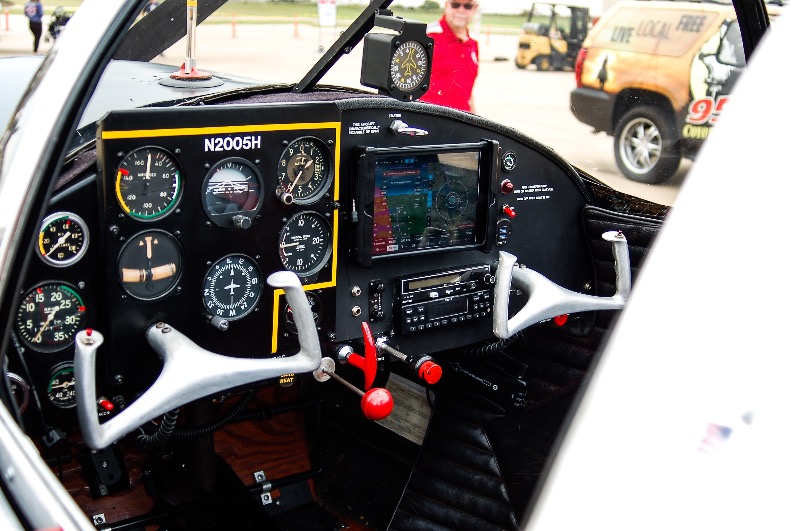

Looks nice, can't do it, I'm wearing your instrument panel around my waist.
07 May 2020 19:02 #23
Replied by Lawson Laslo on topic How much does your ERCOUPE WEIGH?

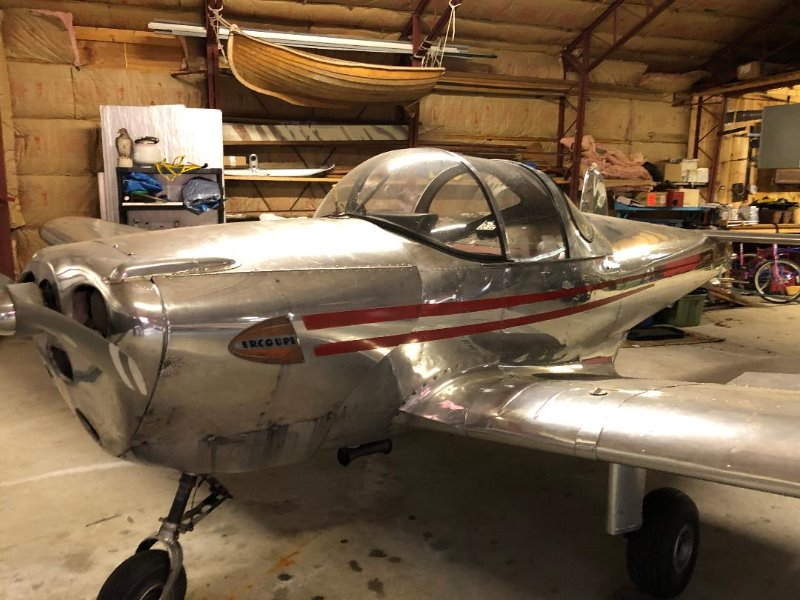

Hello all, just purchased a 1946 415C Ercoupe. I won't see it for a month or two with this Covid stuff. I have beat up all the
Wikipedia files and understand all the variants of Ercoupe, Sanders, Forney, Alon, Mooney, C75, C85, C90, O-200 etc.
I have seen weights all the way from 750 lbs to 939 lbs. Well like most of us that age, we pack on a few pounds.
So I am curious, how much does your coupe weigh?
Mine is a plain, no paint, C75, no rudder pedals, no radios 415C. How much should it weigh? As I said, I don't have the logs yet,
don't have the weight and balance info yet. Mine should have a gross of 1260 but am considering getting the increased gross weight
STC to 1320 next annual inspection for more useful load. Keeping it LSA.
