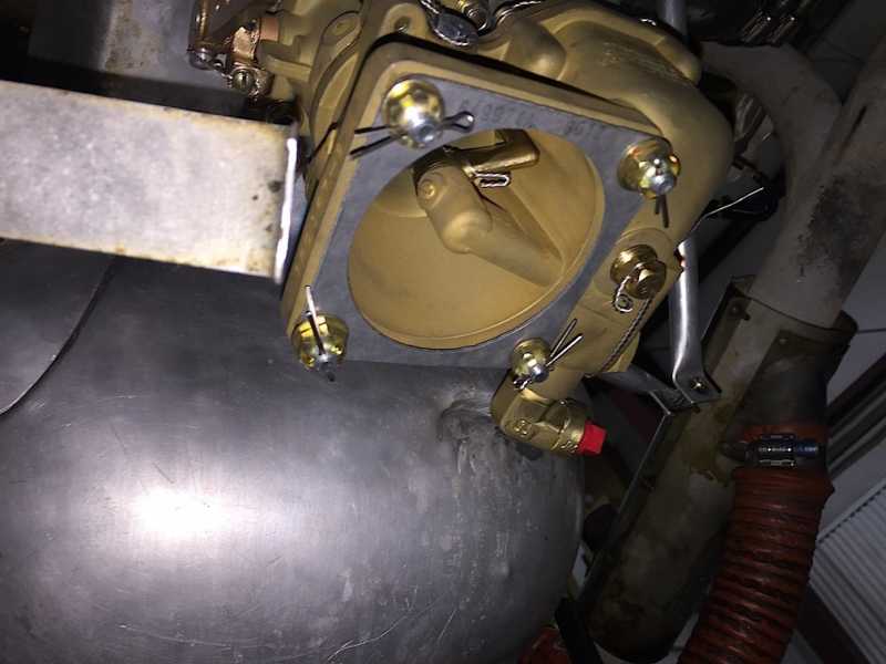

We just yesterday got N3976H back from a month long "extensive" annual inspection.
As part of that we made the decision to send our carb out to the "Stromberg Specialist" and I have to say I could not be happier, and compared to my overall maintenance bill, I think his $1K fee was a bargain. We'd been having flagging performance for a while, and there were some clues the carb might be to blame. As it turns out, a previous owner had run the plane with garden-variety auto gas and the carb was full of guck. The Specialist said it was the worst he'd seen in his career. Imagine me explaining that I didn't starve the cat, it was half starved when I adopted it….
Anyway, when it came back it looked brand new! (See before and after images). More importantly, flying home yesterday I got better performance that I've ever had since we got the plane in 2013. It was amazing. I highly recommend this guy.
But now I need to learn to fly all over again! (I'm not used to "normal" performance.)
